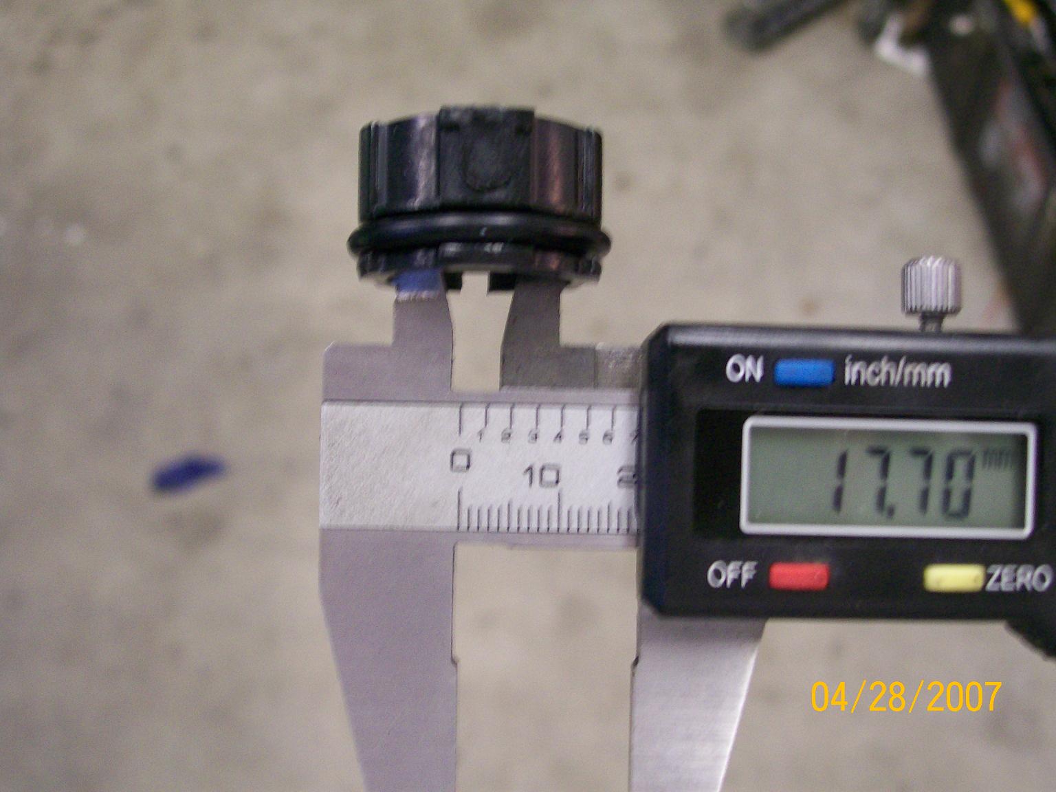

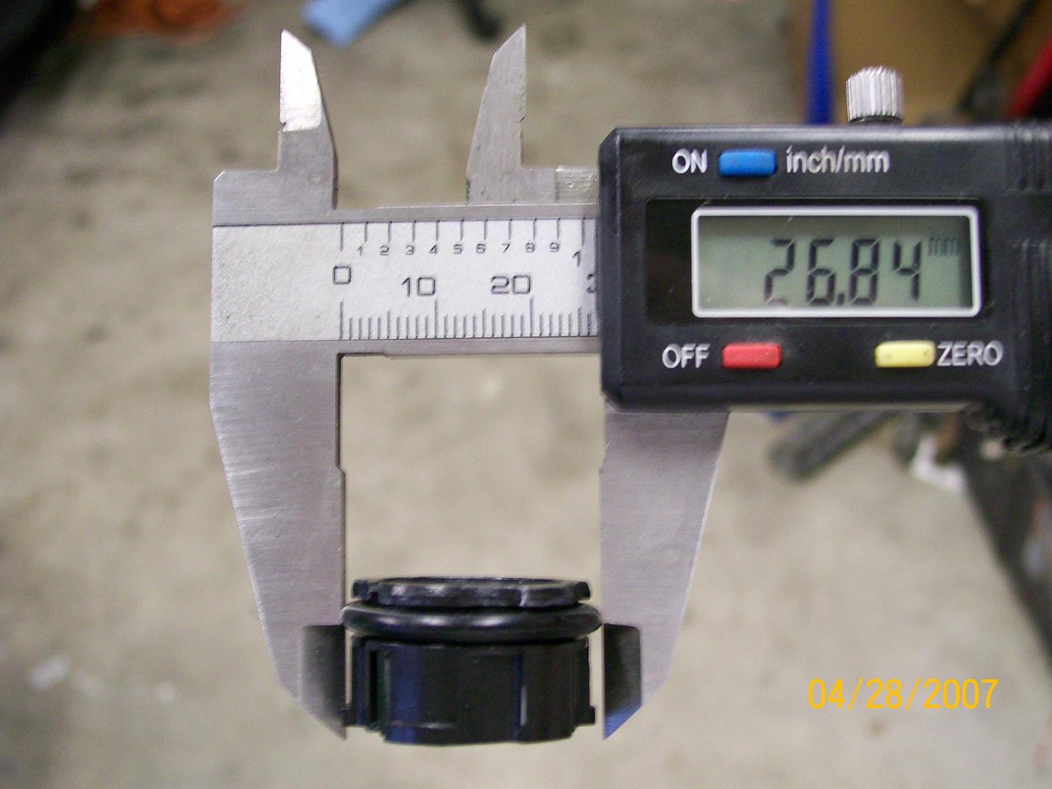

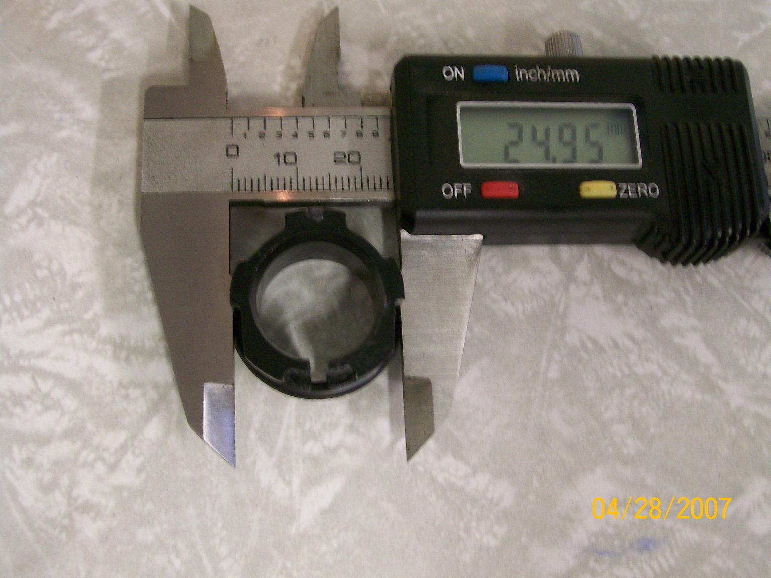

Hey guys, I installed a new steering column bushing in my 74. It's the bushing that goes between the steering column and the tube the column rides in. Prevents the steering wheel from just flopping around. Fixed it. Had to sand down three small protusions on the O.D. of the bush with dremel, sanded down about 1mm. Took 30 seconds with dremel.
I have a source for more of the bushings. Don't know if it'll fit a 77. I'm posting pictures with measurements so you can measure to see if it'll fit your REPU.
Anyone want to do a group buy? $30.00 shipped to upper 48 states, buyer sands down to fit. Again only took 30 seconds with dremel with grinding stone attachment.
O.D. of bushing measured at the O-ring. You can see two protusions on left and right u grind down to fit.
O.D. of bushing measured at body of bushing. 3 protusions easily visible.
I.D. of bushing

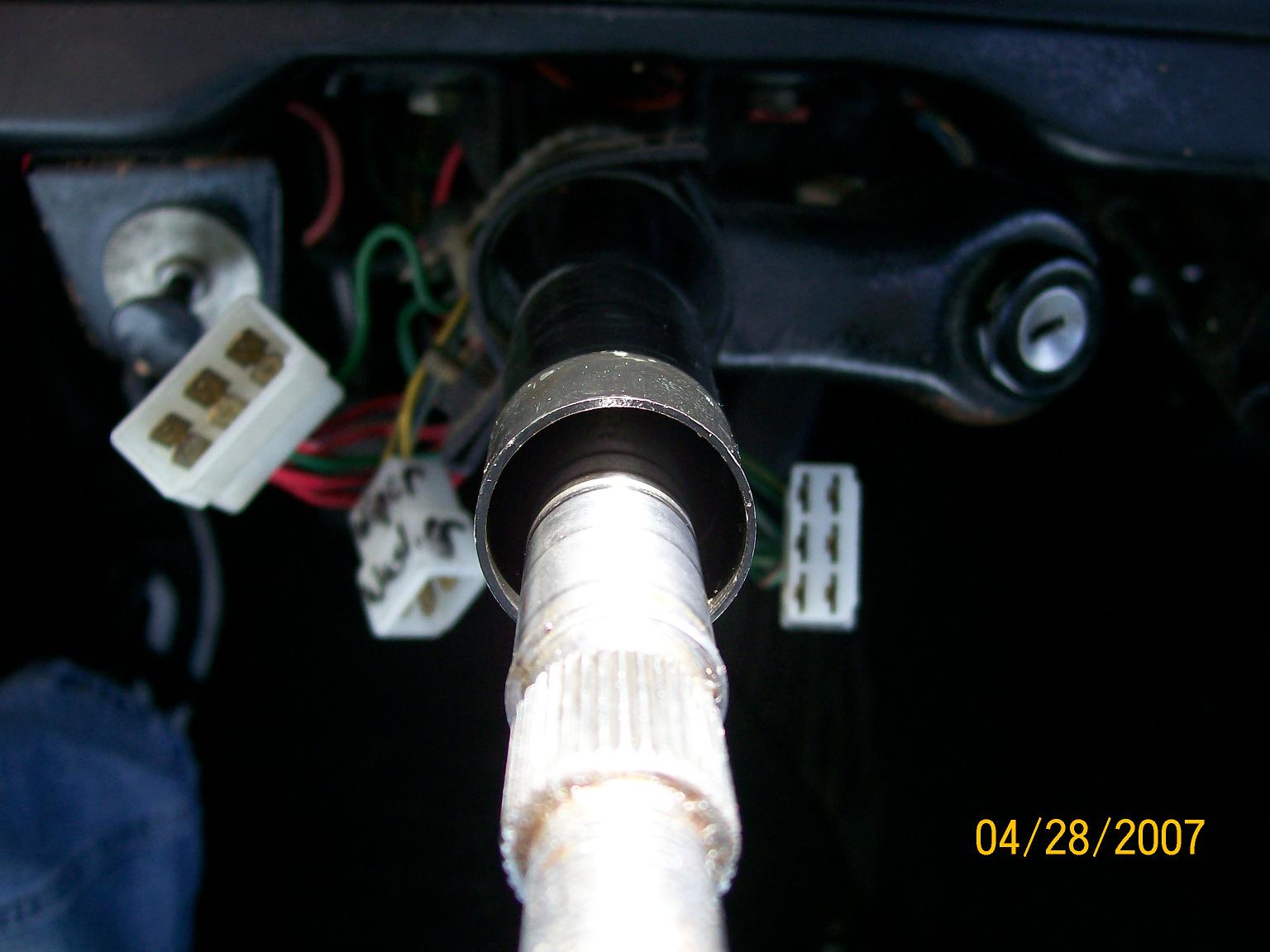

That's where it goes.

can you take a pic on how it goes into the steering column? please? thanks!!!
