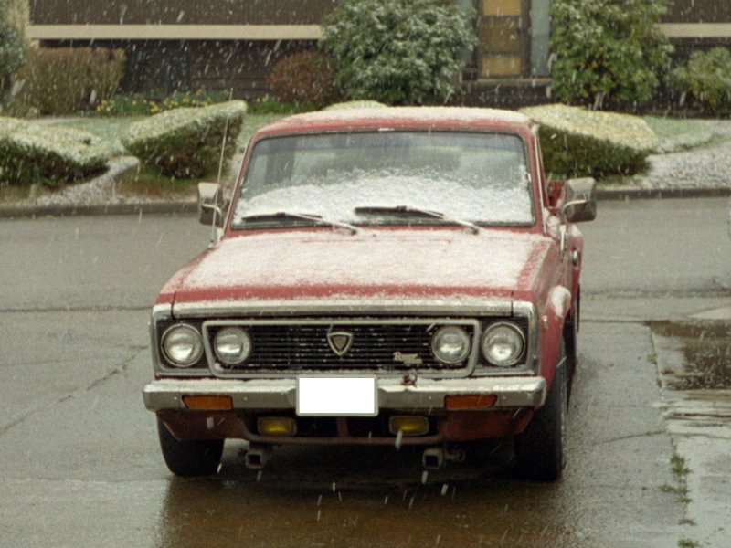

And here is my truck with its B2000 rims.
![](http://www.mazdarepu.com/Gallery/uploads/truckside.jpg)
![](http://www.mazdarepu.com/Gallery/uploads/snow.jpg)
Check out how narrow the tires are. The offset is really pretty bad. I'd like to get my steering box fixed soon so I could start using my wider alloy rims (not pictured).

Jeff what is that sticking out from under your truck?
Jeff20B
![](images/blank.gif)
![](images/star.gif) ![](images/star.gif) ![](images/star.gif) ![](images/star.gif) ![](images/star.gif) ![](images/star.gif)
Moderator
Posts: 661
posted May 27, 2002 10:26 PM |
You mean those two square tubes? They were on it when I got it back in '97. I think they were for some sort of tow bar or something. There is also a hook mounted on the bumper right under the Rotary Engine emblem. I once was going to remove the tubes, but then discovered how nice they are to set jack stands under. They also take parking stall 'cement thing' abuse so my lower valence panel doesn't have to.
