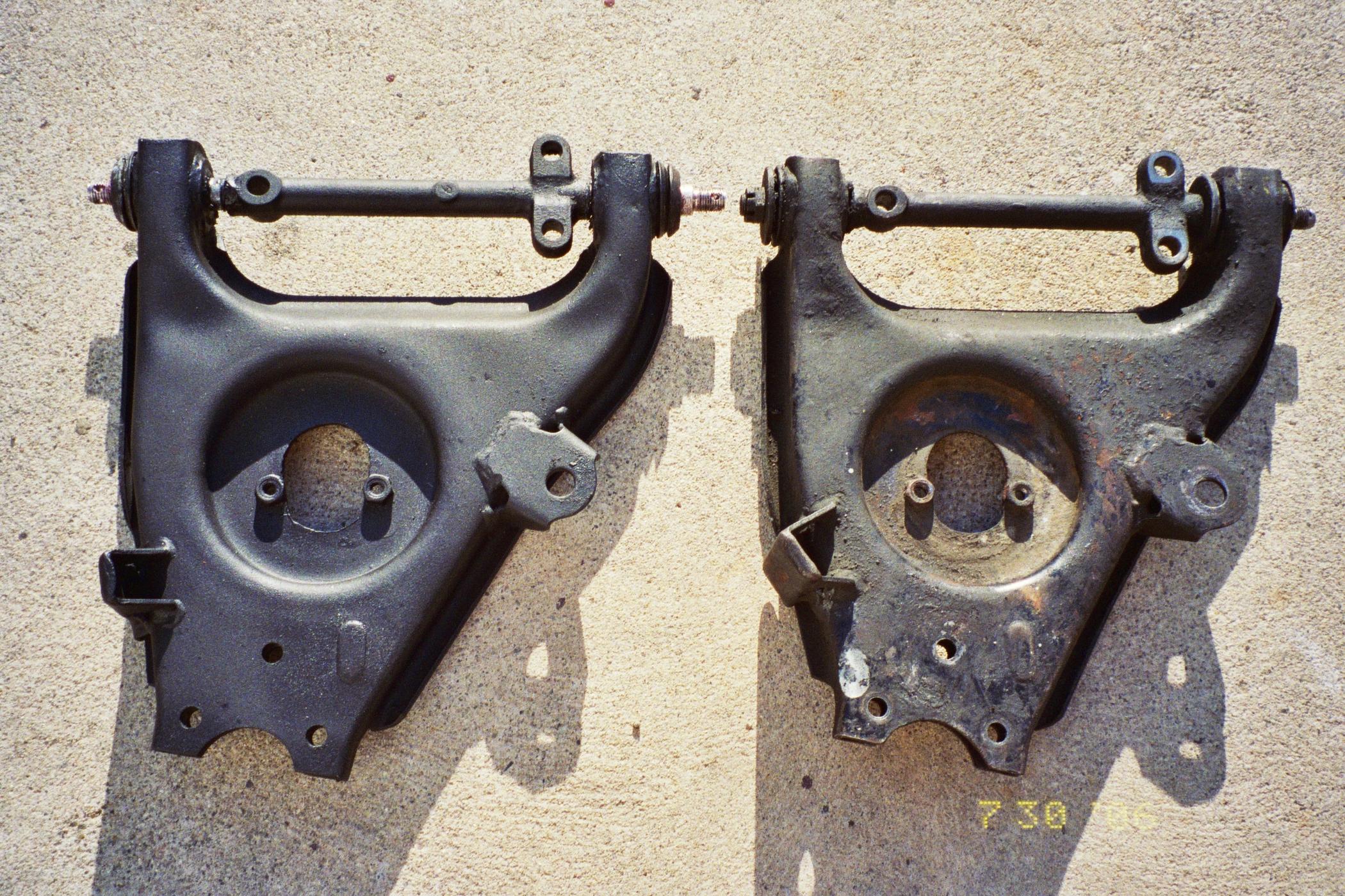

Yeah, the shocks can rub the inside of the threaded sleeve especially if there is a lot of play in the a-arms. Like worn bushings. Or if the sway bar isn't on there right it can pull the lower control arm forward. Or if the alignment is way off. Or if the LCA's or their rods are bent. The new sleeves (gold colored) that I sell have a tad more inner clearance than the old black ones. Installation of the coilovers is straight forward as long as you put the perch on top of the spring nice and level. Did Gary put new poly pads under the springs? That prevents them from sliding around and cushions the blow.
I have not compared Gas-A-Just to Bilstein and don't know the compression and rebound rates of that shock. They are stiff. I can tell you the Bilstein HD shocks work great and are a firm shock. It doesn't wallow or porpoise on the freeway.
I don't have a pic handy of how to dremel the ears on the shock's lower mount but it's straight forward once you see how it goes together. I think I dremeled inward 1/8" each side, just enough so you can get the bolts to like up with the lower control arm nuts.
Here's a pic of the lower control arm, and you do have to dremel the large center hole to clear the thicker shock.
