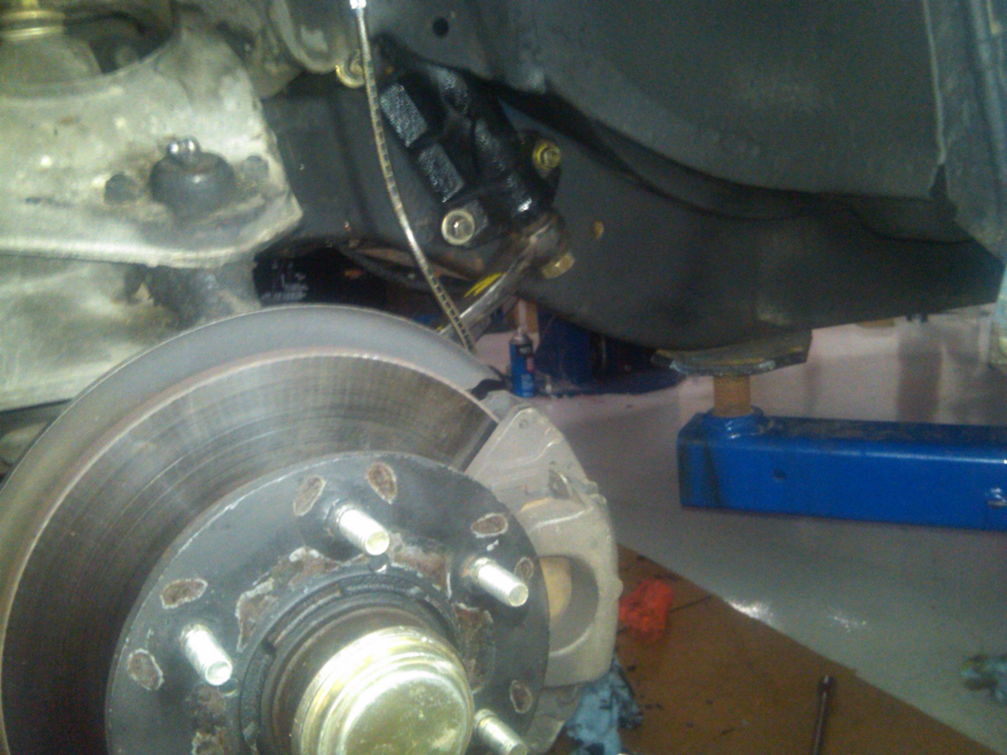

Another Option (Other than rebuild) for Worn Steering Boxes
There's a thread in this section talking about steering boxes, and one of the users mentions he swapped in a steering box out of a later mazda truck. The only drawback the user said was he needed to swap over the entire front suspension (knuckles, drag link, tire-rods, etc.) from the donor truck.
I went looking on car-part.com and saw they had a box in my state from an 84 B2000 with only 15k miles on it for $75. Figured for that money and that low of a mileage part, I could experiment to see whether it fit.
Turns out, as long as you swap over the pitman arm from the REPU box, it fit my truck using the stock suspension parts perfect. Had it on there for 4 or 5 months now, and other than the unusually accurate steering (for my truck, anyway ;-)it's been perfect.
I had to grind a small flat spot on the steering box input shaft (which matches the original REPU box) and also grind one of the edges slightly on the large 2.5" or whatever nut that holds the steering box together. If that nut is clocked with a flat spot towards the truck, you probably would not even need to do that.
Posted some pics in the gallery in the "Mazdamark" folder. If you look close you can still see the original paper "NSK" sticker on the box I picked up.
FWIW, it made the truck totally different to drive. I can place it in the corners now, instead of "guiding and suggesting" like I had to with the old, worn out box...

Anyone know how to re-size this img so it doesn't make you scroll or re-size your page to see it?
