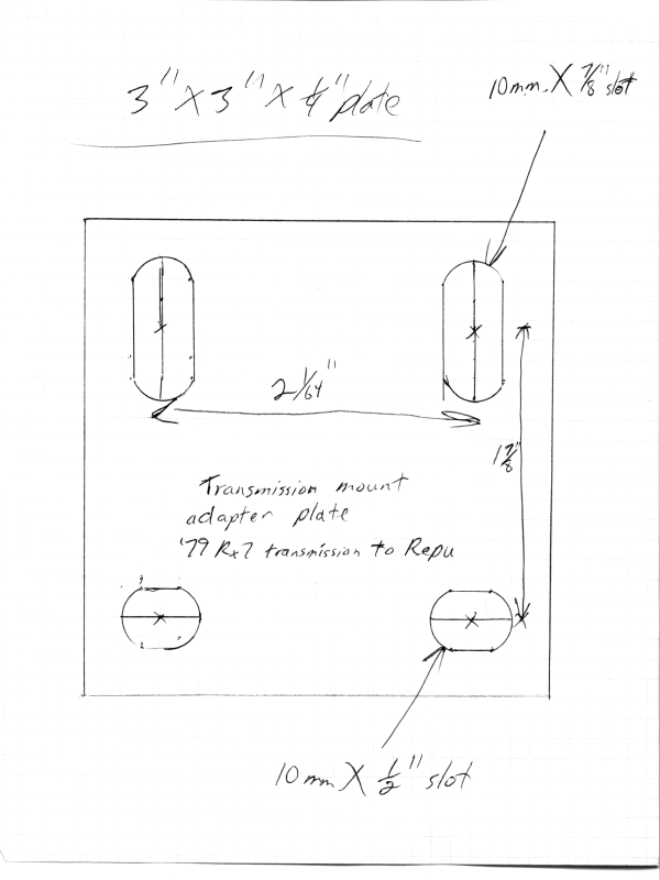

posted April 12, 2012 05:30 PM
I found this drawing on my harddrive. Not mine, haven't checked the numbers but looks about right. Enough to get you going.

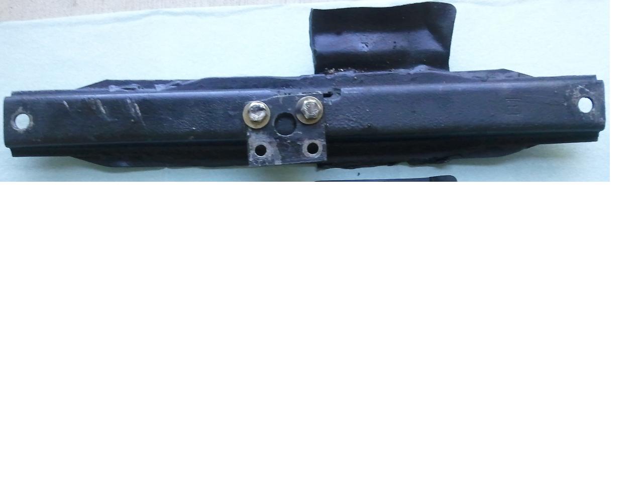

posted April 13, 2012 01:55 PM
I have the original drawing out in my garage. Worked perfect on my 74, had to pry the engine a bit on my 76. Tired motor mounts I suspect. It should work for you. Another pic is in the forum files.
