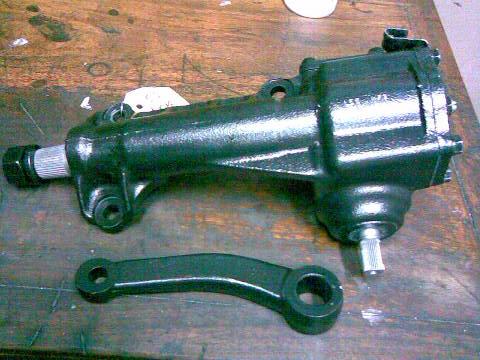

steering box
they're still having trouble finding seals for it. said aftermarket has nada and they'll take it to a MAZDA dealer parts dept.
posted April 15, 2008 11:13 AM
all the hardware is done but mazda and ford don't have any seals for it. they're gonna try to find some seals in the shop that are close and either modify the box to take it or switch to o-rings. joy
posted April 25, 2008 12:39 PM
they found a new catalog for National
and the new catalog has METRIC seals. they ordered some.
-brad-

OMG it's done!
$254.17 and ships out to=day.

posted May 16, 2008 01:03 PM
Arrived yesterday. All cleaned up, painted. Stamped "LEE 05-08" Looks good. Turned it by hand, seems like less play. Turns smoother.
Install it in a week or so.

posted June 02, 2008 10:55 AM
Okay, got it installed
But the brake booster and surrounding area had rust so I stripped that down to bare metal and am painting all nice and perty. Should be able to drive it later this week.
It does feel smoother but I can tell even with the wheels removed and up on jackstands that there still is steering wheel play. There's definately less play than before and I think it's less than an inch of play so it's within spec. Part of the problem is 5 balljoints and an idler arm that the pitman arm has to move (4 tie rod ends + 1 on center link). Compared to a rack and pinion that only has two tie rods to load up and move and typically have quicker ratios. The other contributing factor is the truck's steering box ratio rather slow which equates to being easier to turn the steering wheel and big tires, but the front wheels turn slower.

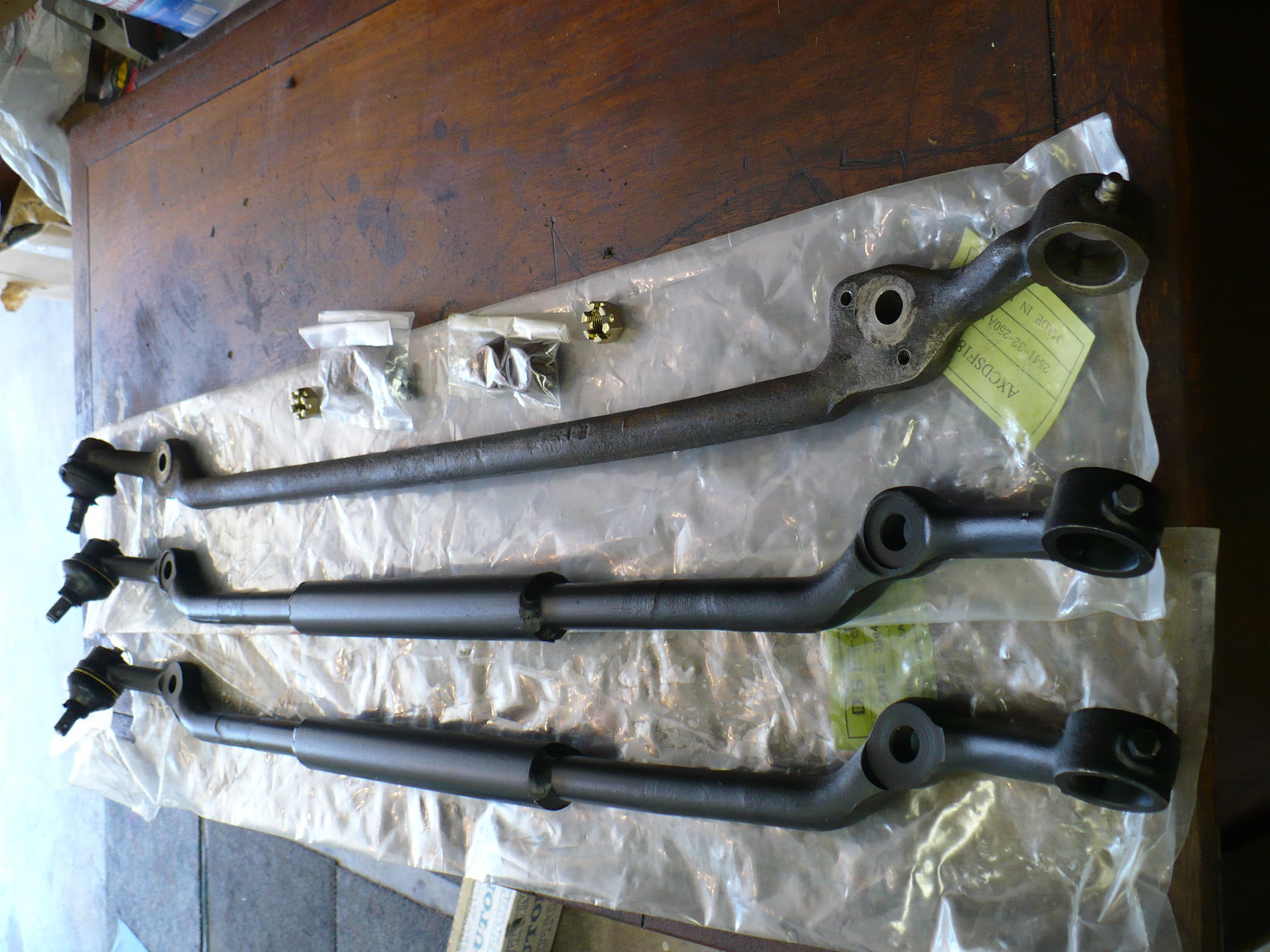

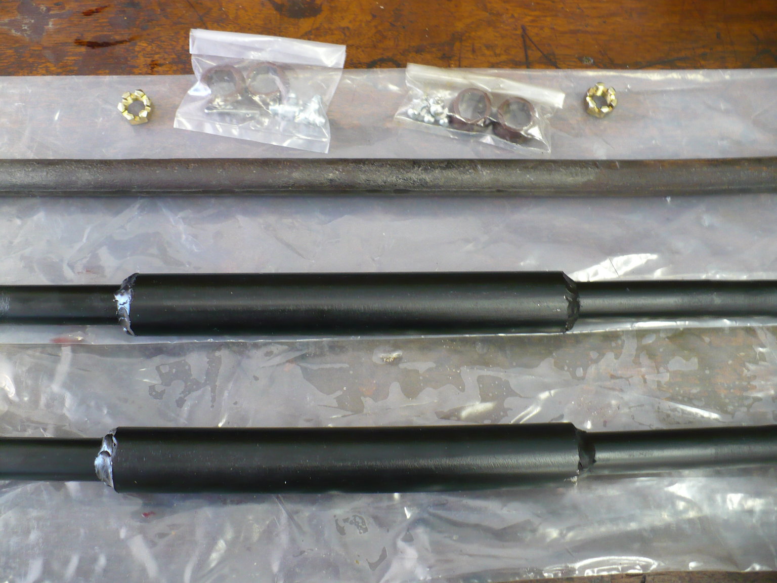

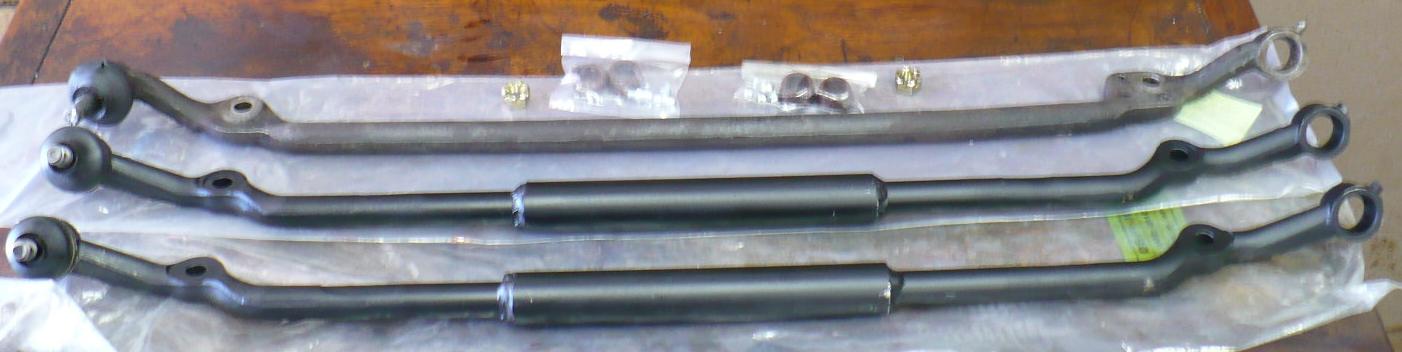

Talked to Sparky who thinks he may be able to weld them up for less. And lives not too far from me so I can drop off a completed one for comparison. But it's a cast steel piece which gets tricky. I'll let Sparky chime in as he's welcome to weld.

I don't see why welding won't work. May invole pre-heat and special rod. I actually just thought of a better idea.... I have a spare used courier center link (Thanks Wvoight) just checked the diameter of the center section, identical diameter of 1/2" pipe. It would be really easy to cut and thread center section with extension piece of pipe. Use couplings and 1/2" schedule 80 pipe for extension. Tack weld couplings to keep everything tight. May even use jam nuts to lock threads. Tell me what you think. Brad...how much did you increase length of you midified center link???
posted June 04, 2008 10:51 AM
I think that's an option but not really necessary as we have tie rods to adjust the length to set toe. Personally I'd rather have it welded and solid; two less threaded items in the steering to worry about coming loose, stripping, or bending. Plus if it's threaded then you can set the ANGLE wrong - have it cockeyed.
It's about 4" longer.

Good point Brad....When I replace my center link I'll try the threaded pipe option. I'll use couplings with jam nuts and tack weld everything. A complete weld would be stronger, but I think it's overkill.
