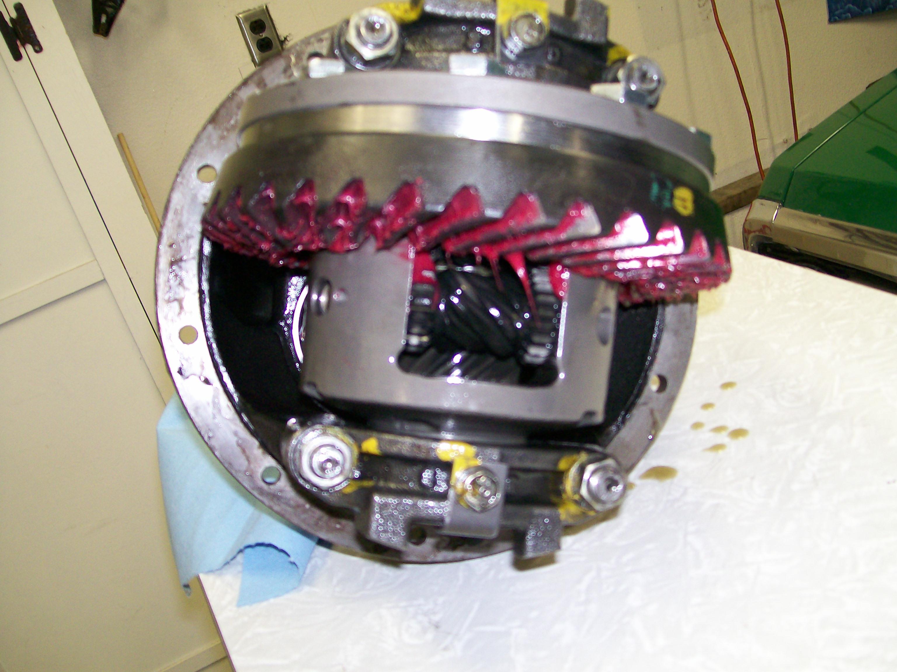

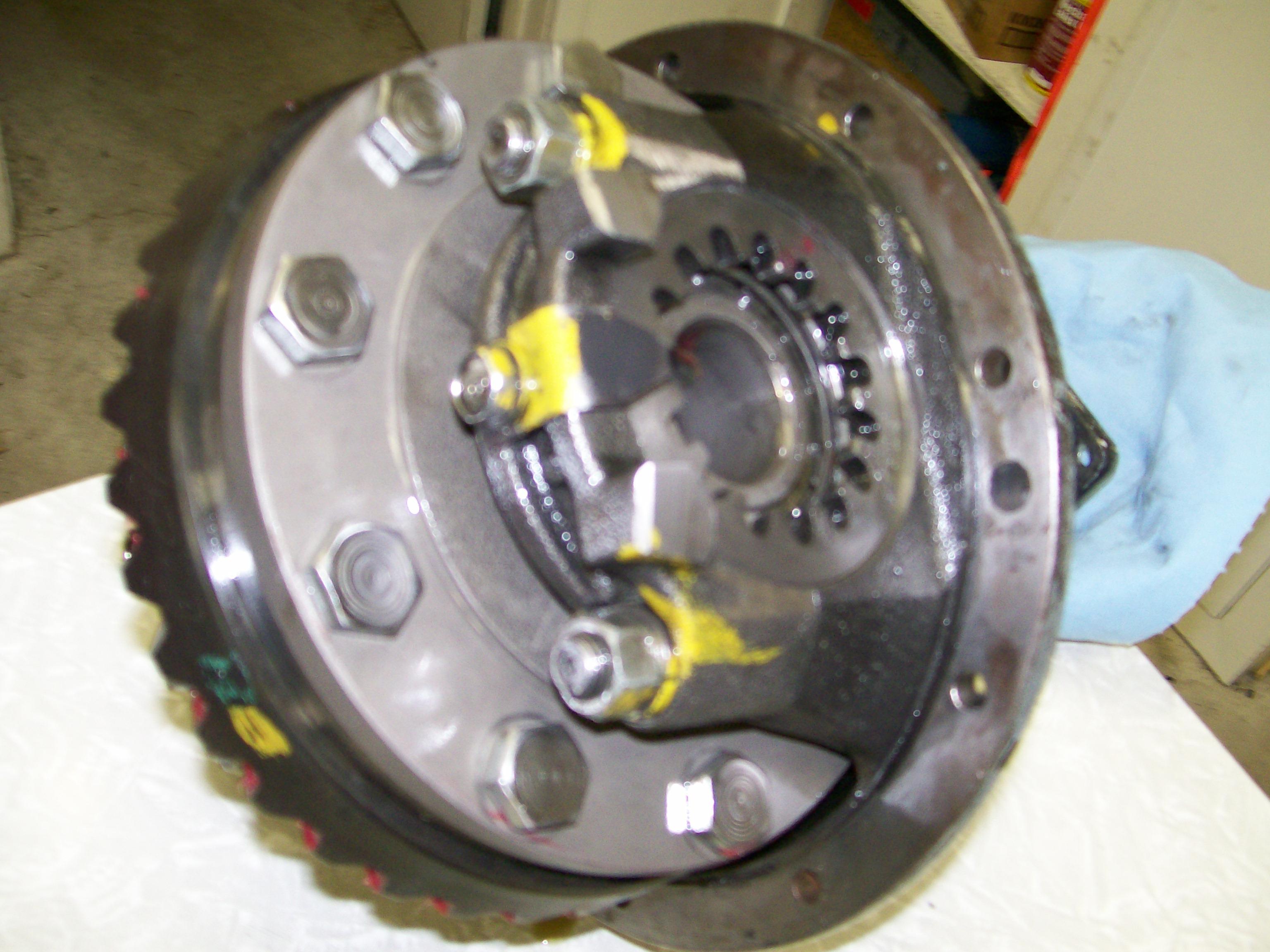

It is finally possible to have a limited slip differential for your REPU. A 3rd gen Rx7 Torque Sensing limited slip aka Torsen can be made to work in your REPU. What you will need:
1. The two spacers and longer bolts for sale as a kit
2. A Torsen from any 3rd gen Rx7 that you supply

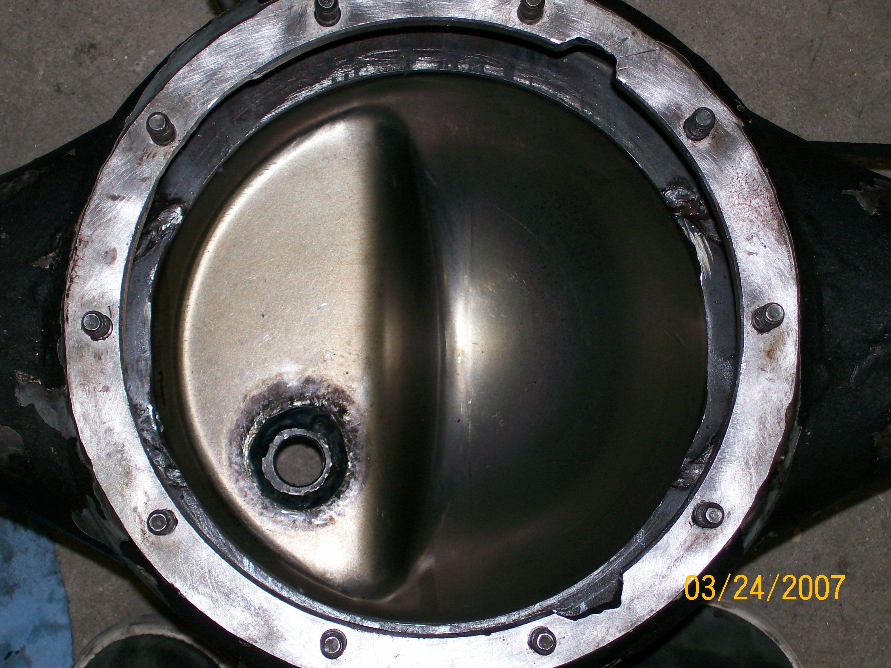

3. Grind two notches in REPU axle housing flange
4. Any REPU gears and stock REPU pumpkin housing
The two spacers and longer bolts can be purchased directly from Rex Armour, machinist. $200.00 shipped to upper 48 states. Contact him directly @ fuzzyeyed@yahoo.com for payment instructions.
The large spacer with holes drilled in it goes between the ring gear and Torsen, allowing proper setting of carrier spread. Longer bolts supplied to compensate for spacer. The small cylindrical spacer replaces the thrust block from open diff, and goes inside the Torsen for both axles to butt up against. Since the entire rear end must be dissassembled, it is critical to set pinion depth, carrier bearing preload, tooth pattern and axle end play back to factory specs.
Grind notch in axle housing so bolt heads can clear.
I've had this installed in my REPU for a month and the truck really puts the power to the ground. Accelerates slightly quicker (no lost traction), handles much better as it no longer understeers on corner exit like an open diff. It's easy to point the truck thru a turn.
