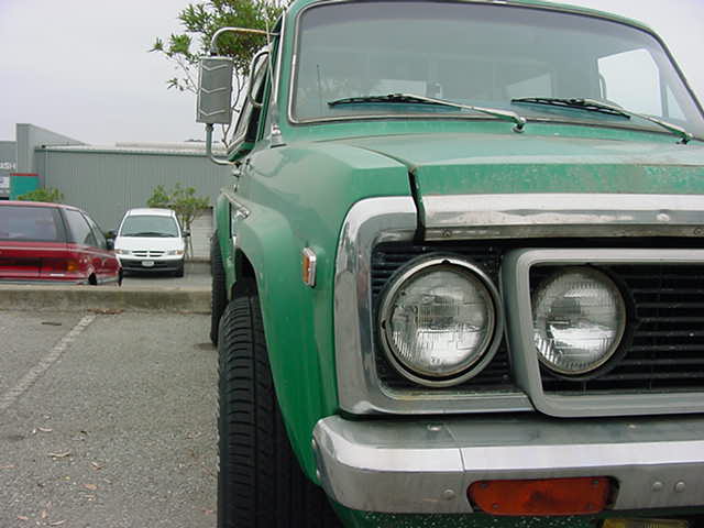

235/60/14 dunlop
brad
posted May 21, 2004 08:34 AM
Edited By: brad on 21 May 2004 08:38
235/60/14 dunlop
Only rubs on the drivers side fender. very lower front corner edge. only when hitting a pothole. just need to bend the fender a tad out of the way.
